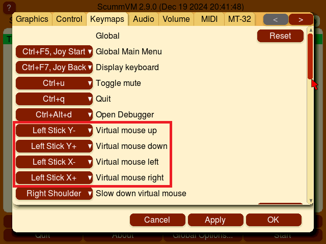

“DPAD Stick Mode” diagonal movements have a higher speed, for example, the cursor in the ScummVM launcher. Which is not a very convenient experience. Stick vector normalization will solve this problem.

If you press dpad RIGHT and UP direction (Vector2(1.0, 1.0)) you will get vector length = 1,414, which is higher than 1.0 (for non diagonal directions). Vector normalization after pressing dpad RIGHT and UP give you Vector2(0.707, 0.707) which length is 1.0

I would like you to change the stick emulation logic or add an option for this behavior to get the same value in all 8 directions
the logic would have to be added to ScummVM program, which we didn’t write.
ScummVM was just an example. When using external gamepad with sticks, I get uniform cursor movement because the stick position is limited to a circle
ScummVM uses a stick already emulated by muOS
