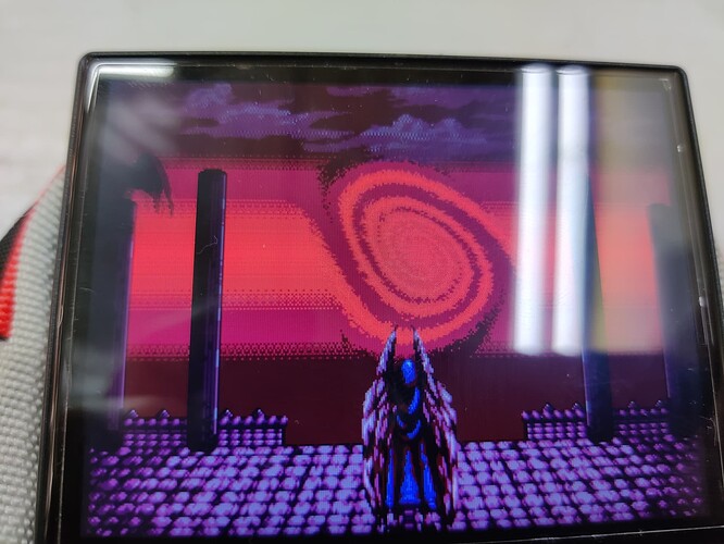

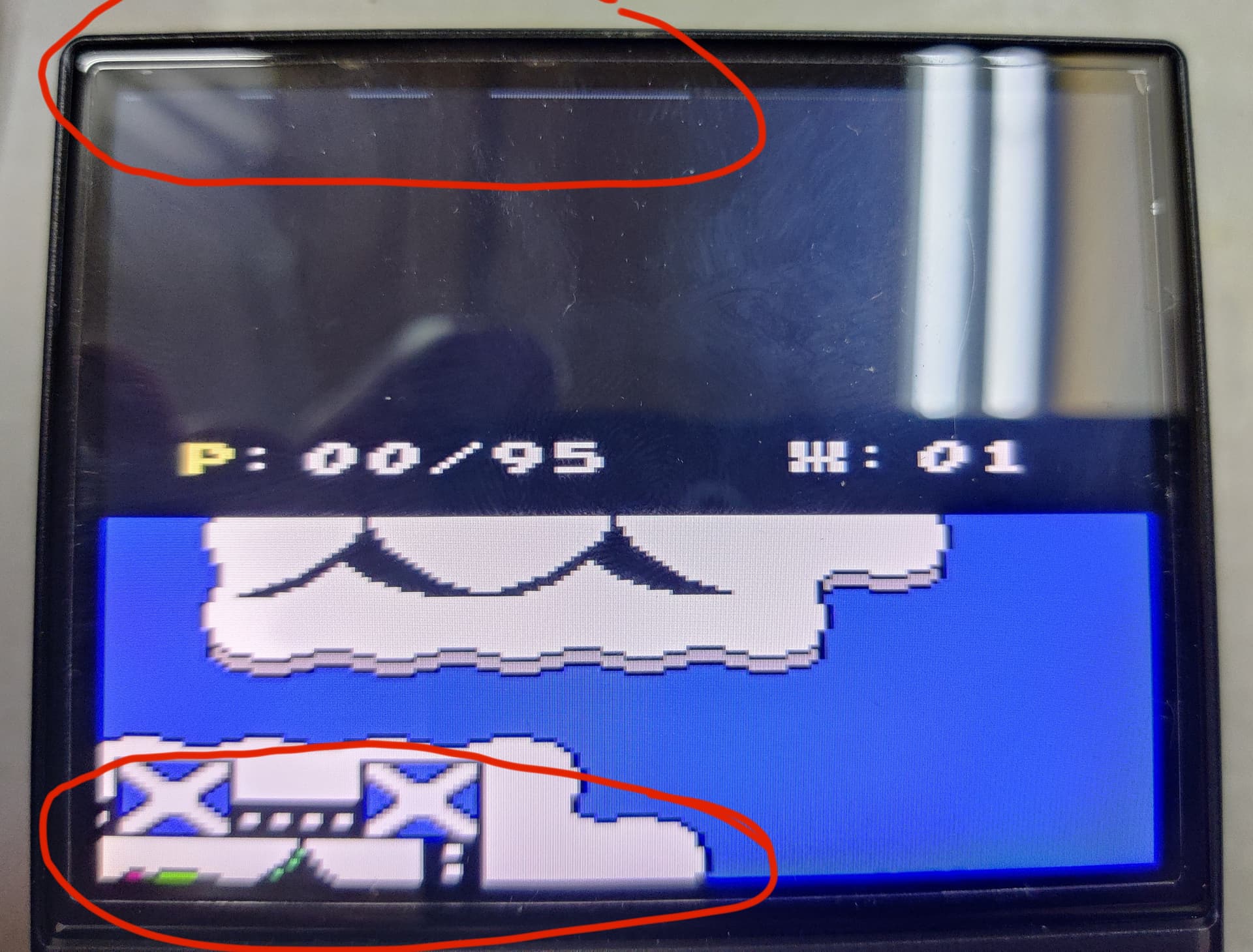

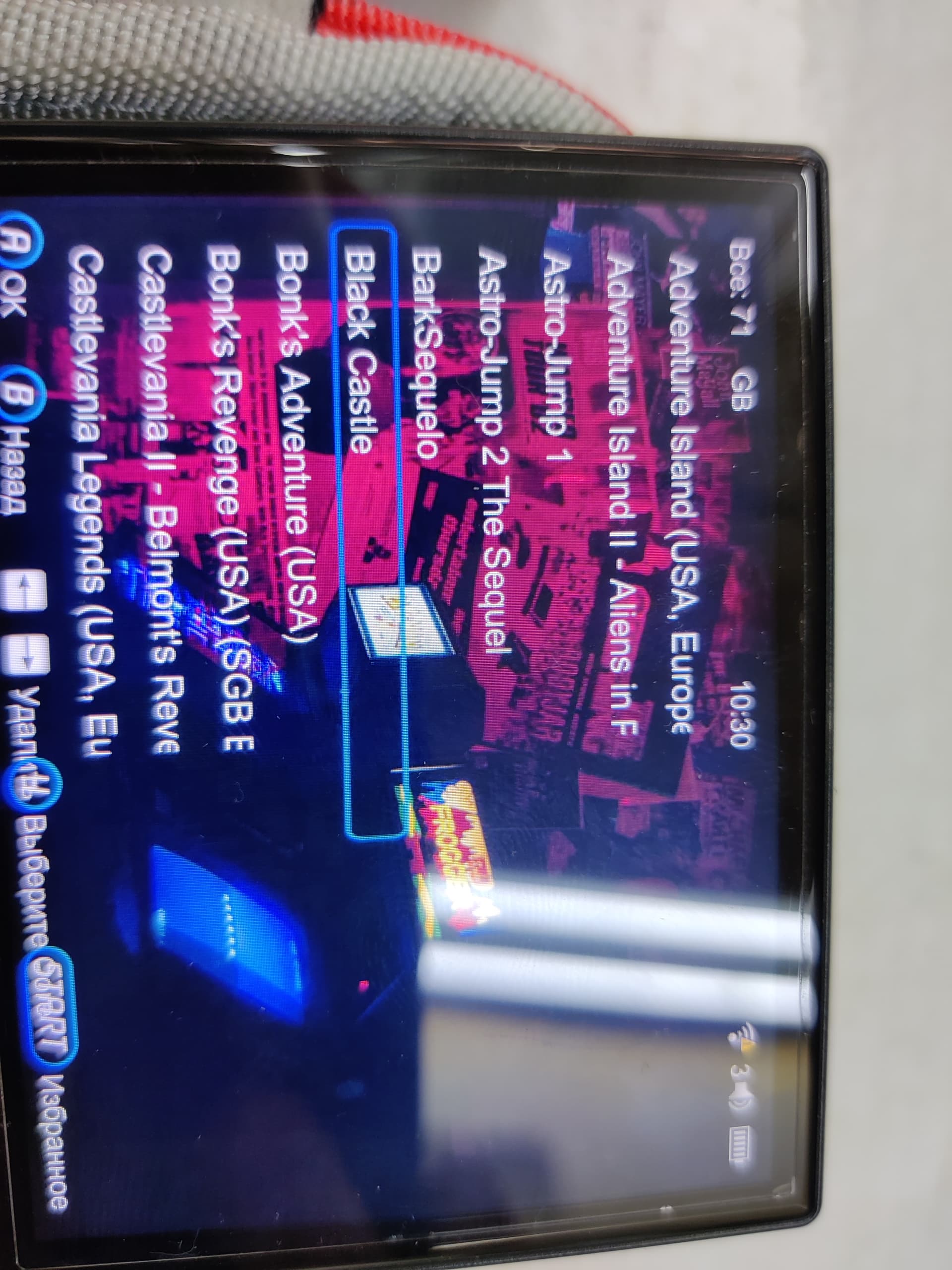

Rg35xx plus. Content is displayed with approximately a pixel offset, which can be seen in the screenshot. This is evident in games, applications, and themes.

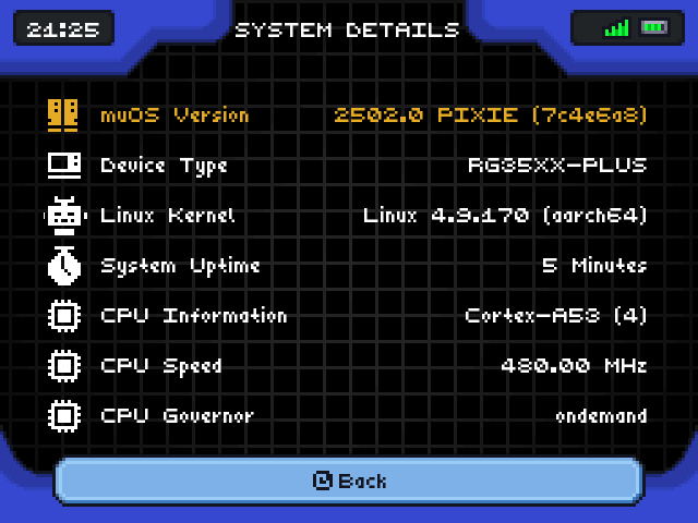

Can you provide some more pictures of the issue within the menus and applications? What version of muOS is reported in Info>System Details?

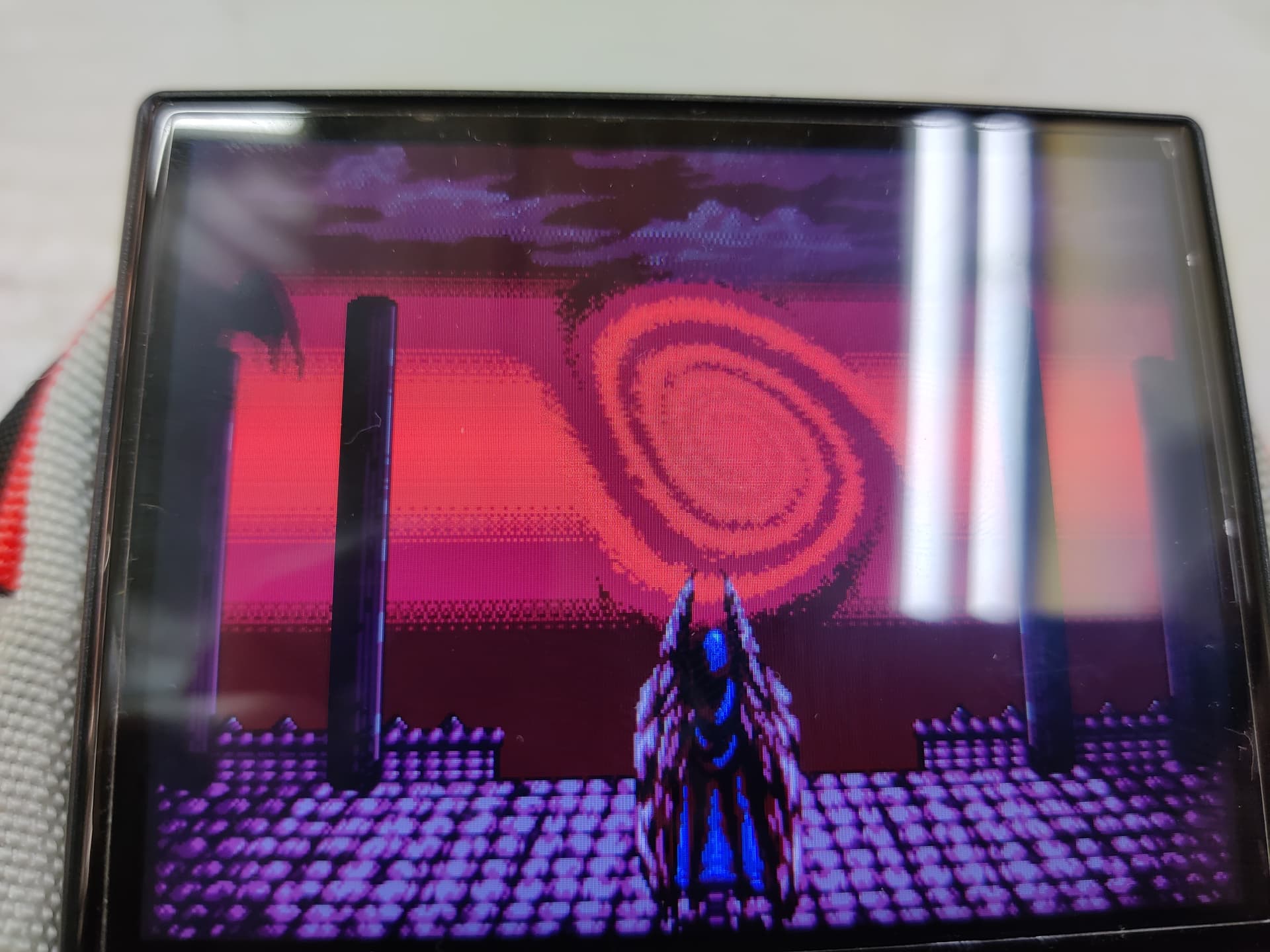

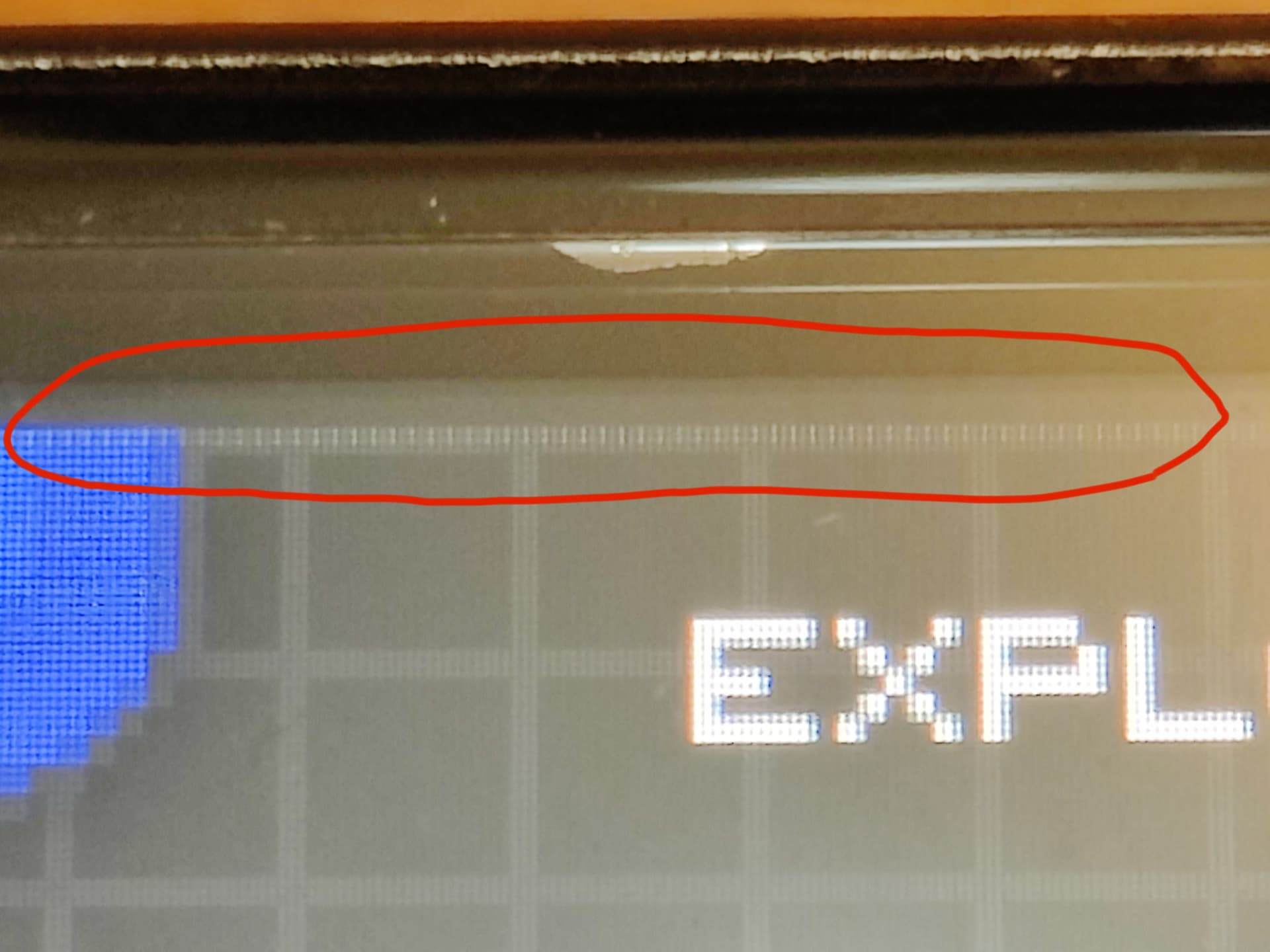

As you can see, everything is fine with the screenshot, but the display on the screen gives such a glitch of transferring the lower pixels to the top of the screen. I did not notice such a problem with the banana.
That is a very odd issue, indeed. This exact problem haven’t been reported before, but it can be due to the panel revision on your device not being compatible with the current muOS version. It is more common on the SP model, but can happen.
I will suggest a simple re-flash, with another sdcard if possible, to double test things out, and checking with other firmwares, or the old banana version of muOS, to see if it is happening only with the Pixie release.
If it happens with other firmwares or the stock OS, than your screen may need a replacement.
Yep, unfortunately other than trying a fresh flash, with a different sd card if possible, to double check the issue with Pixie, I believe you fall in this category of issues:
